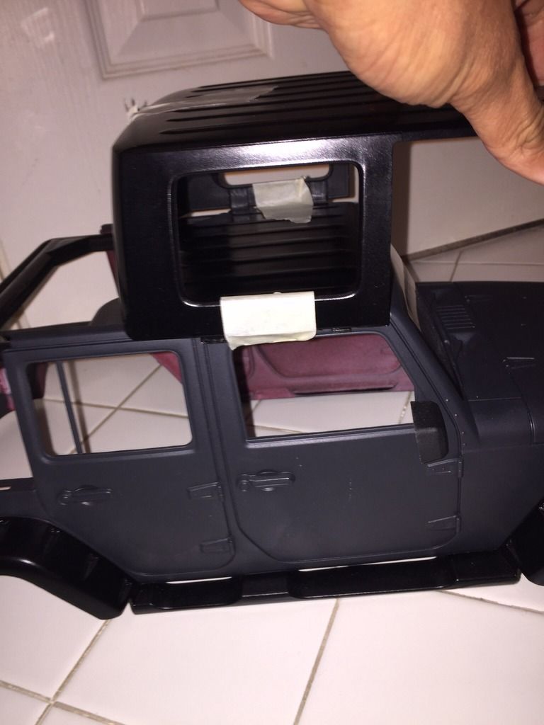

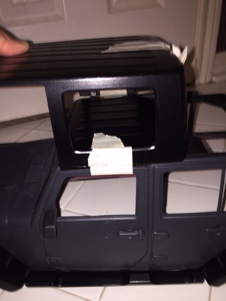

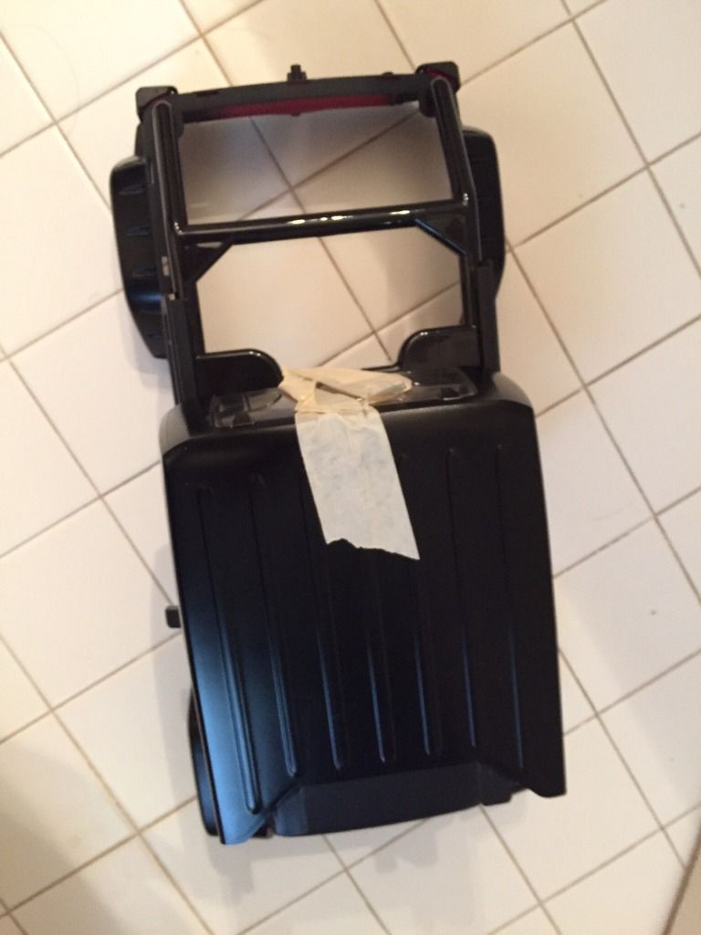

    My body so far the masking tape is a rough idea of where to cut and eventually styrene it together and putty the holes sand and redo until perfect. Then wash...primer....sand....primer...paint. I want to keep it olive drab green with matte black trim.
    The plastic fenders and running karts are a to to be chopped off since my buddy is gabbing those for me.

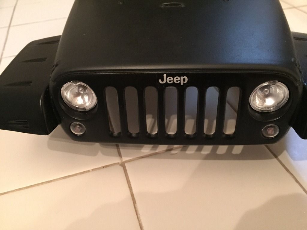

    Front end already a little work. Need to find scale radiator or mesh behind grill. Also need a snorkel. Can the Tamiya TJ one be bent and heated to fit and look proper?
    Thanks!
