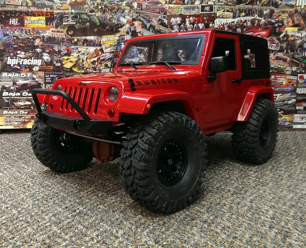

    Here's a pic of the C2 TerraMod Ultimate kit all running less body and battery. Quite a compact little thing that runs fantastic!

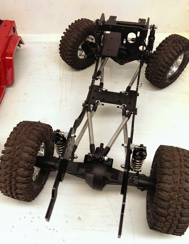

    I did finish building the SSD axle truck today, and it's really really good. I made the bent panhard link straight again (from the Axial Ultimate Skeleton Kit) and then spaced it 5mm longer, and that's the only change for the SSD housings over the Axial SCX housing.
    Stuff on this truck:
    Chassis kit: GCM Racing WebStore-2015 - J2 AXIAL ULTIMATE Combo
    Bumper Mounts front and rear: GCM Racing ShapeWays Store
    Wheels: GCM Racing WebStore-2015 - Baja Detroit BL 1.9 Rim
    Hubs: GCM Racing WebStore-2015 - Black GCM LOCK Scale Hub Set
    Axle Housing: GCM Racing WebStore-2015 - D60 Axle Case for SCX - SSD059
    Tierod set: GCM Racing WebStore-2015 - TI Steering links for SCX - SSD024
    Hubs: GCM Racing WebStore-2015 - SCX Pro C Hubs Black- SSD068
    Knuckles: GCM Racing WebStore-2015 - SCX Pro Knuckles Black- SSD066
    SCX10 Rubicon Bumper Set front and rear
    Really nice stuff! Pics shown below:
