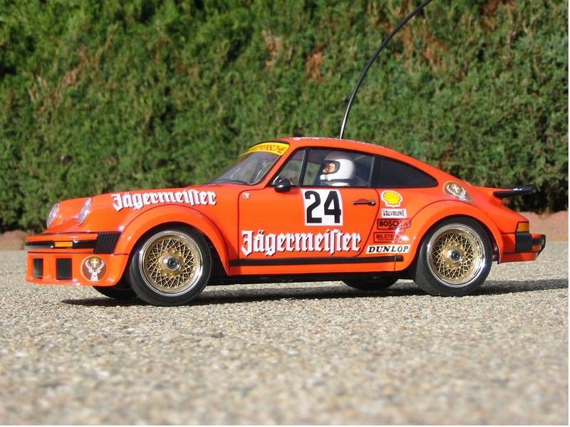

    The follwing two pics hopefully demonstrate what I mean (I have to add the shutlines as well...)
    Original:

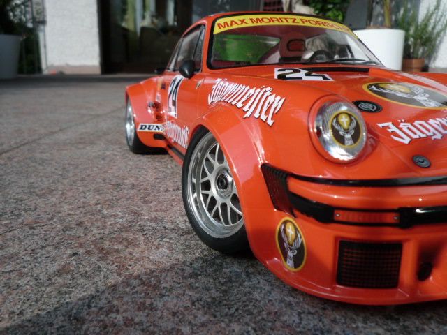

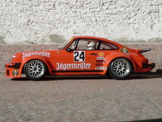

    After modifications:

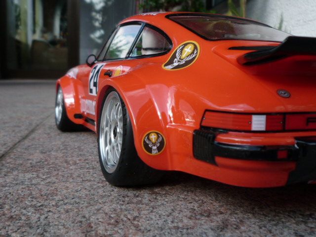

    Modifications:
    - Increased toe in of all 4 wheels
    - Reduced ride height by limiting the damper rebound with internal rubber inserts
    - Pretension springs to reduce maximum deflection on bumps (accommodate for lower ride height)
    - Use lower viscosity oil in dampers to smooth suspension movement (avoids hopping)
    - Replaced kit rims with Kawada M-chassis size rims (imported from Japan)
    - Manufactured adapters to accommodate standard 12mm hex rims with smaller hex of GB-01 chassis axle ends
    - Increased offset with shims on all 4 wheels
    - Mount tires with larger sidewall (front: Kawada M-chassis, rear: Tamyia 58002 Porsche 935 front wheels)
    - Dremel off the wheel arches to more scale look
    THat is it as far as I can remember. Look nicer doesn't it?
