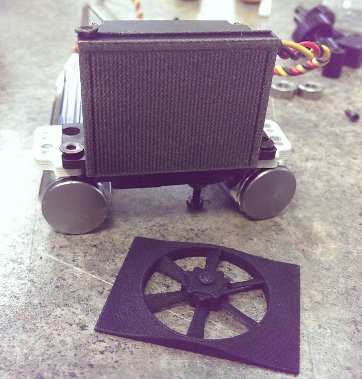

    I was happy to install this new radiator and fan shroud I made up. Because they're 2 parts, it's really easy to detail before assembly.
    The rad fits over the steering servo nicely to cover the non-scale stuff under the hood. Easy.
    You can see a bunch of the engine detail there also. Like the belts and steering pump and such. The plug wires are made from a small copper wire, which is drilled and plugged into the engine head, and then glued on top of the distributor. The rad hoses are likewise made from a larger copper wire, and the same basic ideas applied. The nice part about using the copper wire is that it holds the shape you bend into the wire, so it looks tidy for a long time.
    These white parts are prototype stuff I made up for our new C-MAX chassis we are releasing soon. It's a full C-Channel frame rail setup designed for leaf springs and adjustable wheel base. The motor/trans/LRTcase also has 5 mounting positions on the length of the rail to allow an exact fit with your firewall or engine bay setup. It's really easy to use so far.
    Under that scale V8 motor is a HOlmes Hobbies 13t Crawlmaster brushed motor, and the power wires are coming the back of the block. It should be easy to route the wires down and around the transmission to get them hidden away.

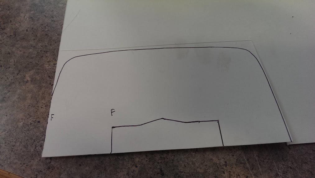

    I decided on a solid body mounted firewall for this unit. First was a cardboard cut out trimmed to size, then traced on the styrene sheet and knife'd out.
    Then I dotted it in to the lexan with CA glue and finger wiped a nice clean bead of shoeGoo all around to seal it in both sides. This works great and is super tough. The firewall also holds the hood opening in the proper shape thanks to the floppy front end now.
    I then painted it flat black as well as the hand-bent front styrene rad support cover at the front of the hood (which was also shoeGoo'd in to the underside of the lexan.
