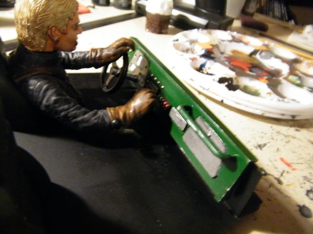

    ok enough about all that. I want to explain how the basics of all the painting i do works. first thing that must be done is to primer surface. always,always, always primer. I prefer to use white primer and flat or dullcoat. for fine stuff i use Citadel white primer in a spray can for bigger stuff (like a wild willy figure ) I use krylon rattle can in flat white.
    next step is to put on your base coats. i usually put all my base coats on the entire model if it is to be more than one colour. once you have that done i will mix up a shade or "wash" to apply over most of model. If you look at this figure of willy it will help me explain what i mean. i painted on the brown for the gloves,the grey for the shirt, all the black and silver bits, the red on the hat, and lastly the flesh tone.
    once all the base colours are dry ( less then 10 min dry time with citadel paints ) I use a black shade that has been thinned down with water, applied with a fairly good size brush to put a light glaze over everything. except flesh. for the flesh i use a wash that is called "gryphon Seppia" which is a reddy brown wash. what these shade coats or washes do is settle in to all the low spots on the surface of the model and give a nice shadding effect when they dry. i will use the flesh as an example. first coat is a colour called Bronzed flesh. then wash with gryphon seppia. you can see the shading around nose lips and eyes. Another great thing with these washes is that they can make broders on your colors. when you go from one color to another on a model it really makes it "pop" if there is a very thin line of black between the 2 colors. for example between the brown glove and the grey of willys sleeve. the wash will do just that for you.
    painters trick #1 if you are trying to paint a surface and the paint just seems to bead up in droplets and not lay flat or spread evenly, it has to do with surface tenso of water. to counter act this you need something called 'flow release agent" very expensive and only found at art supply stores. the trick is found in every grocery store and you probably already have some in your house. its soap. the soap added to the water allows it to flow. dish soap works ok but can make paint go chalky. the best product i have found for this is a called Future no wax floor shine. a very small drop in your mix of paint and it works wonders.
    once the shade has dried you go back over and hit the raised areas of models surface with a base coat to reinforce the colour. so on willy shirt i did the grey then black wash then back over only the high spots of folds of fabrics with the same grey paint, thinned down with water to make it almost s translucent coat allowing the shading to show through this coat of paint. on the face same thing. back over the high spots with bronzed flesh again.
    next step is a highlight. it is either a lighter paint or the original base paint lighted by mixing on a light color to tint it. so on the grey shirt i use base paint with a bit of white mixed in. on the face i use a different color that is called Elf Flesh. it is a nice light skin color. sometimes it works good to do another highligt coat if needed. just mix another layer of paint a little lighter. for example on the gloves i use a base color called 'snakebite leather" shade wash then use base coat again. i then keep mixing in a color called 'bleached bone" to give it a couple hightlight coats, until i get the look want. the best thing to do when experimenting is to thin your paints with lots of water. this lets you build up the highlight color gradually. don't try to smear a bunch of thick paint on it will make for a hard line between one coat and the next which doesnt look good.
    we are almost done the last thing i always do is clearcoat all models. either dull coat or gloss. what this does is seal all the layers together and put a protective coat over top to stop chipping and scrtching. it also gives a uniform top coat. usually i go cheap and find that Testors dull coat is the best. smells bad but works great. it is compatible with every type of paint i have used. never had an isuue with it reacting with base paints. cheap and comes in spray cans. it also seems to help blend the coats of paint together.

    another great way of making textured surfaces really look awesome is "drybrushing"
    I imagine alot of people have heard of this before, if not tried it. the name pretty much says it all. using a drybrush to apply a very light coat of paint to the very tips of a textured surface. the place i always use this is on hair. however i have done it on seats and other textured surfaces. take a look at the hair on this model. it is the best pic i have to show you guys how it works.
    so the first step was like any other paintin i do. base coat and let it dry. in this case i used the color bleached bone to make it look like blond hair.
    next was to do a wash with chestnut ink. it is a very brown toned ink.
    after the ink has dried i take a fairly good size brush and dry brush the base color back over top. to dry brush the way i do it is to load the first 1/3 of the bristles of the brush with paint. I then wipe almost all of the excess paint of the brush. i then wipe even more paint off either on a paint tray or on a paper napkin. which i always keep handy to clean my brushes with anyway. the idea is to remove enough paint from brush so that you can very lightly brush the surface of the model and it put a very fine amount of paint only on the top of the textured surface. how do you know if you have gotten enough paint off brush before you start to try applying to a model? the trick i learned is to brush the side of my index finger and if only the finger prints get highlighted you are there.
    again take your time and do several light coats. if you want it highlighted more do another coat. I have heard someone else say this..... if you get to a point where you aren't sure whether to put more on that probably means its time to stop.
    the last thing i did on this particular model was to mix the original color 50/50 with white and do an even lighter dry brush getting just the very extreme tips.
