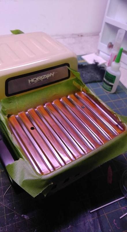

    painting wood not that hard i just did it to my barrage bed started with light color then dry brushed a darker color for the grain and very small amout of black too fpr knots
