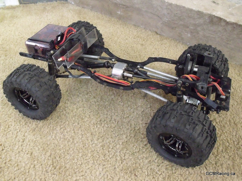

    First step... teardown... well really it took 1 minute, because there's 6 bolts that hold on the entire JK Brute outer cage, bumpers, and entire body, and one plug for lights. After it came off, the project still runs, drives, and everything, it's simply cosmetics that came off.

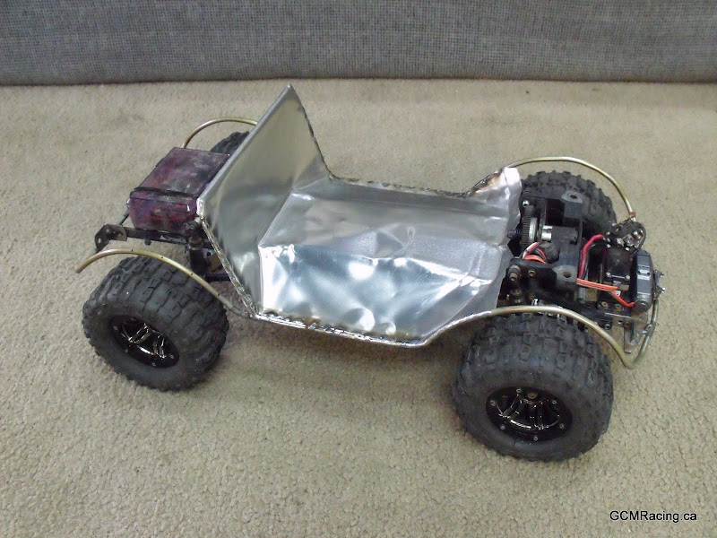

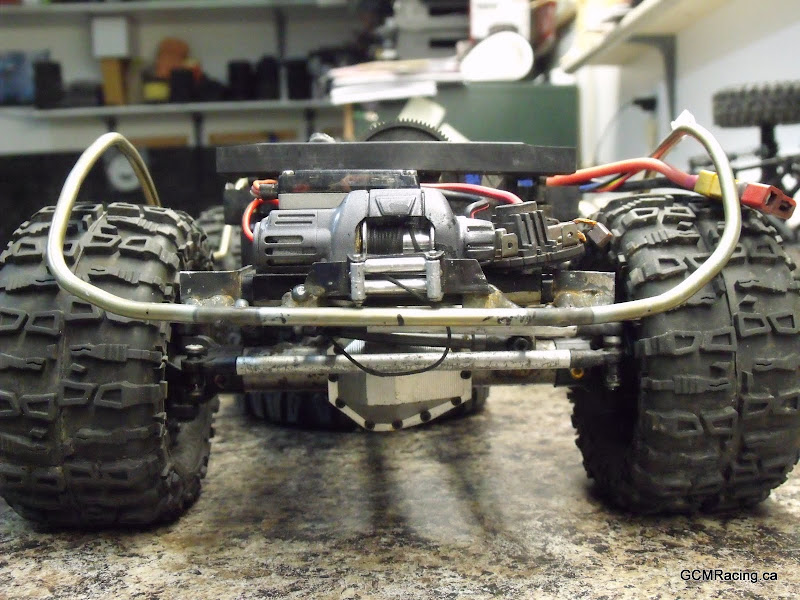

    Next was to start with the same bolt on type of stuff, so I went after the old FlameRanch F250 front bumper that had the winch on it already. Very simple. Bolted it on, and started laying tube work. Added 2 new rear bolt on brackets, and the perimeter cage was done and comes off with the same 6 bolts. Yeah! Getting a new motor at the same time. I ripped a chunk off the comm of the last one
    5,408

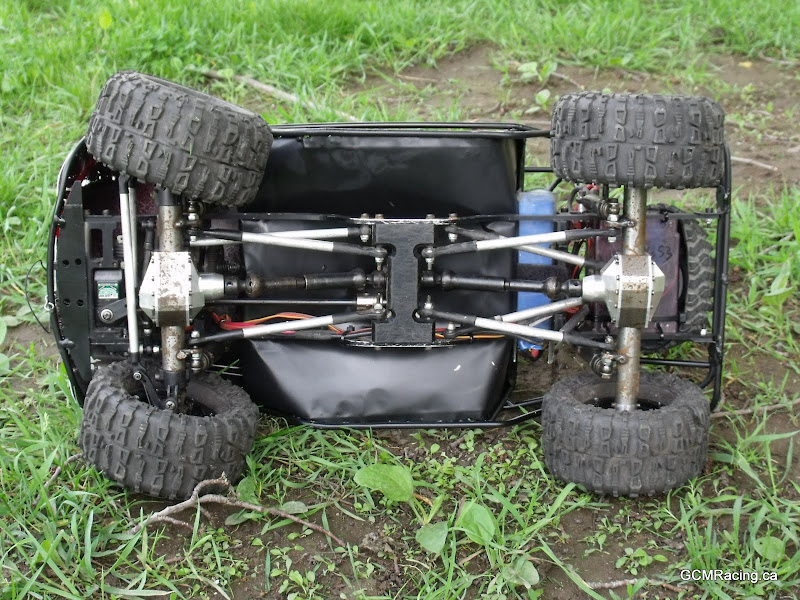

    Next was to lay in a solid floor. I wanted the entire bolt on cage to be removable with nothing more than bolts and plugs, so the floor had to be steel and welded in completely. This turned out to be REALLY easy using a dollar store baking tray! haha! I cut the basic outline oversize, then pressed it down around the frame rails and over the sides, and up the back of the body, and then welded it all over the place to the side tubes and inner tube sections, but nothing is secured to the actual frame rails, so it still comes off in no time. Nice. The thing gets you full scale interior protection and a mega low setup with lots of ground clearance still. And I didn't change anything on this setup from the brute, so it has to work.

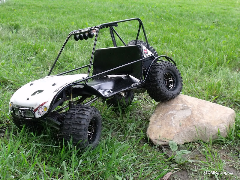

    After some paint, you can see what I mean about coverage. Should work like a charm!
    I had some dead and abused SC truck bodies around from last year's racing, and thanks to the wiiiiide front ends on these, I could chop off the fenders and still get a decent hood! THis is the fitment with some M4 nuts welded to the window pillars in order to attach it. Some 1/4-20 round head bolts and nuts under the lexan make the center hood holes filled, and also doesn't look as bad as an old hole in the hood.
    Got a nice hoop over the winch also, as well as the top rack/cage and all the bracing needed in the rear. Really shows the size of the interior hole now, and that's a 2.2 rim on there with a 4.5 inch tire, so this thing is large! Actually around 1/6 scale or so I'd say. It should look perfect behind my 10.5 inch wide F350SD haha!
    5,408
    So here it is, all running (didn't do anything, it all stayed the same) and stickered up, and with my new HeyOK lighting kit that's all plug and go out of the electronics box in the back. There's 4 front lights up on the top bar, and there's 2 reverse, as well as rear park and brakes, all automated! This is so easy! The only thing I have to put in is the dash and seats and pedals, that's it. The rest is done.... Although I just might try some skinny tires on it to make that scale Razor look a bit more real. But it's a homebuilt after all

    That's a cool little fast build.I really likehow simple that is.
    Nov 2009
    Pooh corner, Ont. Canada
    4,101
    Wow man, that looks awesome. Great idea. Love the scale of it. I'm glad you made it tall like that. Looks like one of those old Honda buggys. A big driver would look great in there to keep the small buggy look. So cool Chris.
    So the Brute can still exist too with just a quick swap? Nice.
    Hillbillycrawler Guest
    Honda Odassy
    ecoli Guest
    Awe, it's so cute That's pretty cool, and unique. Good job on it
    crawlerpawl Guest
    I didn't know what the heck you were building until I saw the pic with the hood and cage - good job, and quick. I agree about the narrow tire thing, it would make it look more realistic.
    3,275
    That's too dang awesome! Love it! Great looking build...
    kyle_l Guest
    now that is thinking outside the box, nice work.
