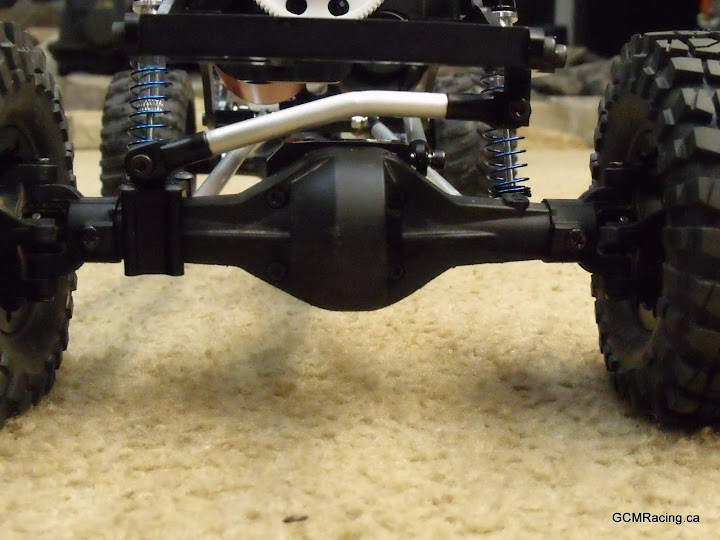

    This one gets the Panhard kit and some proline scaler 90mm shocks up front (shown with MRC shocks) and a new truss from GCM in there also. I chopped off the top of the truss and used it like a 3 link, thanks to the side hole for the upper link, and add to that the bent link the front travel is massive actually. Very cool.
    This is how it looks from the t-case looking fwd with some of my mockup parts and no axles yet. Nice and simple really, and the steering and suspension is dead straight and super tough like this. I'm loving the 3 link panhard stuff now. Very nice and easy to setup.

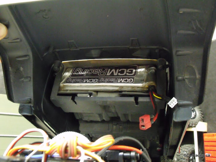

    The battery is just stuffed behind the dash, they always seem to stay there with little to no effort all by themselves, so here I go again!
    This thing uses every bit of extra stuff I could find. I found some old axial steel yokes in my box all with stripped setscrews, so I reamed out the setscrews and replaced them with short ground off M3 screws, and they work perfect, and are easily serviced. Nice. Plastic center axles won't be broken with the rest of this equipment either. It's a saturn HPI 27t motor hooked to a HPI brama speed control, I think it's 30 amps at best, my alarm clock uses more battery than this thing. The servo is a recycled towerpro 995 that's not doing badly actually, and the rx is my standard 2.4 units (have a bunch of them for the 15 model radio). Got a dogbone from HPI and a drive cup set from traxxas for the center trans shaft. All said and done I only really bought paint for this truck, the rest came as trades or old stock or take offs. Funny how that works out after you collect stuff for long enough.

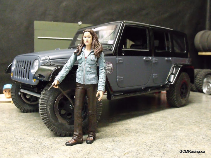

    Had the twins out today for some trailing. Nothing serious, but running machines at the shop, and had some time between parts. Yes, I have a jeep problem. Totally loving these 2 though!! haha! It's sort of a 'his' and 'hers' set now!
